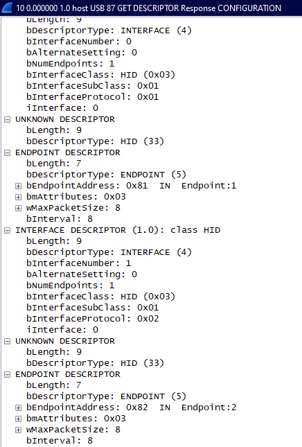

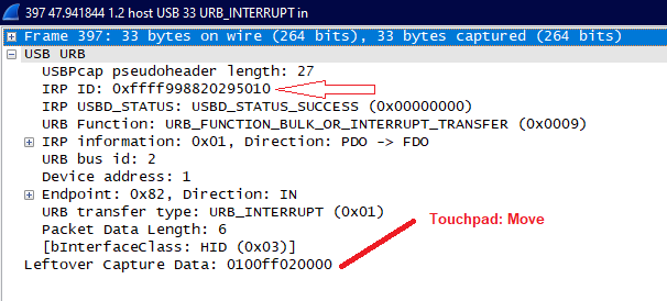

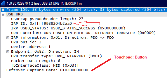

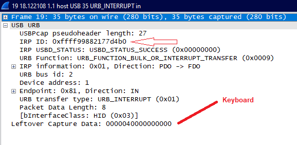

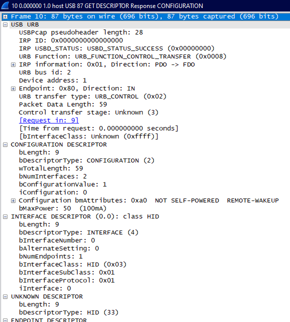

I noticed that the library found two interfaces.
How can I receive data from both interfaces at the same time?
It seems that the library is implementing only the first interface, and when the touchpad is triggered the library gets lost and stops responding.

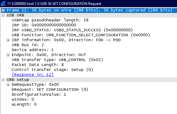

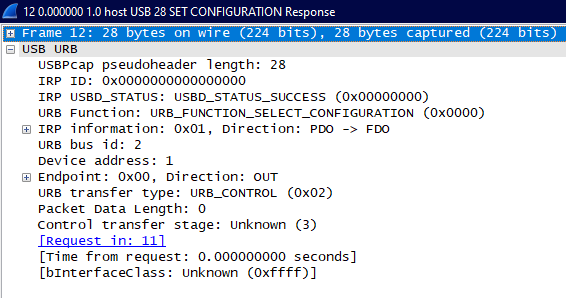

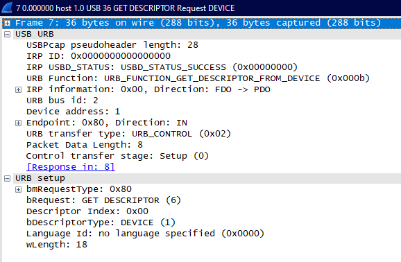

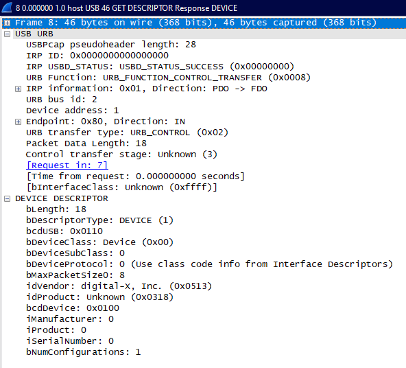

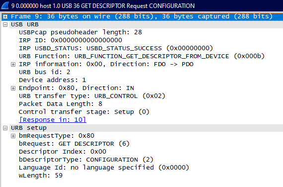

Got some data on Windows using USBPcap
1-Descriptor Request DEVICE:
2-Descriptor Response DEVICE:
3-GET DESCRIPTOR Request CONFIGURATION:
4a-GET DESCRIPTOR Response CONFIGURATION:
4b-GET DESCRIPTOR Response CONFIGURATION:
5-SET CONFIGURATION Request:
6-SET CONFIGURATION Response:
7-URB_INTERRUPT in:
8-URB_INTERRUPT in:
9-URB_INTERRUPT in:
