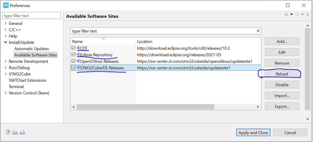

2022-03-08 1:19 AM
Could you try in your CubeIDE 1.7.0 installation to do this:
Window > Preferences > Install/Update > Available software sites
Try to Reload, the marked three update sites:
Any error message?
