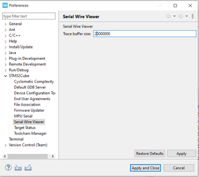

Hello @Jiaming
I suggest you increase the Trace buffer size under Window >Preferences >STM32Cube >Serial Wire Viewer.
Best Regards.
STTWo-32
2024-01-25 5:56 PM
Hello @STTwo-32,
I increased the buffer size in the Serial Wire Viewer, from 2,000,000 to 20,000,000, but the trace still stopped at the exact same time as before, at 73.5s
It seems something limited the trace to continue...Is it because the target does not have enough memory? After the SWV trace stopped, i can see the value in the upper right "Live Expressions" is still updating.

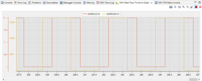

2024-01-26 10:30 PM - edited 2024-01-26 11:54 PM
Hi Laurent,
You are exactly correct! Once I updated the STLink FW from V3J13 to V3J14, it works immediately and no stop anymore!

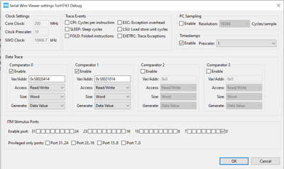

One more question:
How to trace the GPIO pin status in the SWV window? Now I can only type the whole GPIO ODR address. But if there are more than 1 pin active, then the output in the trace will be very strange. Can I use, e.g. PORTB.0 to trace the Pin 0 of Port B?
Thank you in advance.
BR,
JN
