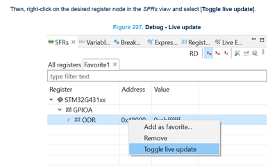

Hi Ali,
There is one way to make it update timely. See the introduction below.
BR,
JN
