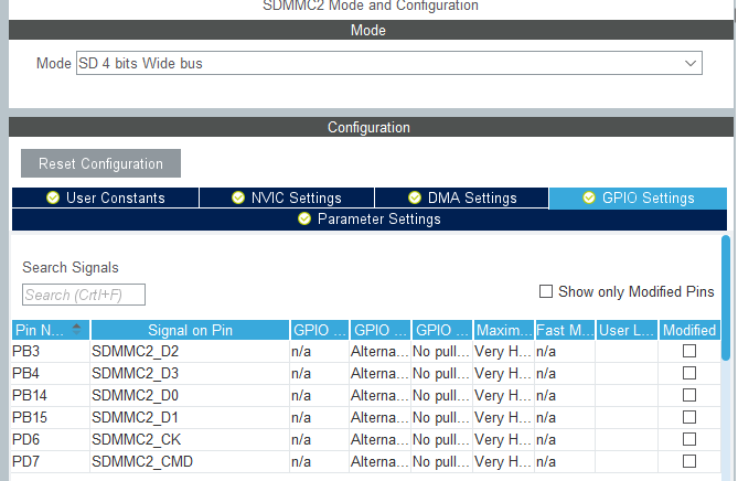

1-bit is working as my end . I am using SDMMC2 .
But HAL_SD_ConfigWideBusOperation() is not generated at my setup as per below setting..
Any thing I am missing..

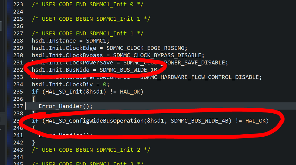

2020-07-16 11:48 AM
I don't see anything wrong in your setup.
I generated a project and initialized SD as 4-bit and pasted the screenshot of what it generated. I don't see why it would behave any differently for you.
You can always edit the CubeMX generated code.
