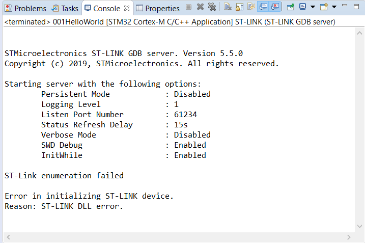

I have STM32F446 board. I am trying to debug a code, but it states that Failed to start the GDB server. I have attached a photo for the problem.
Could anyone support to solve this issue.

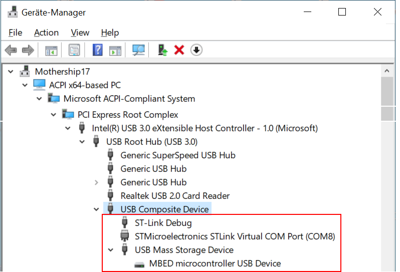

Looks like a driver problem. In the Windows Device Manager (devmgmt.msc, view devices by type) the ST-LINK should appear as a composite USB-Device like
If not, try re-installing from https://www.st.com/en/development-tools/stsw-link009.html

Thanks for your reply. I have installed the driver, but still the same issue.
Any ideas how to solve this issue?
