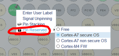

When you assign a pin, you need to assign it to the A7 or the M4 core. It will be initialized in the code for the core it's assigned to. Right click a pin to assign.
If it's not assigned to a core, it will not be initialized.

2023-11-27 6:40 PM
Ah, there we go, that fixes it. To say that's not particularly intuitive is a bit of an understatement . . . seems like that might be the type of thing worth adding to the configuration page (with items like "pin label", "default pin state", etc. Assigning to desired core seems like something important enough to add to this section, IMO.
