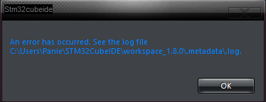

then today, start IDE ( on this new workspace) and it cannot start - just "an error has occurred. see log file...metadata.log" .

open again...and voila : "an error has occurred. see log file...metadata.log" .

now the TEST : close and open ide then... dazong. no more ide , error -> see log file.

close IDE , open --- error (again same) -> see log file.
