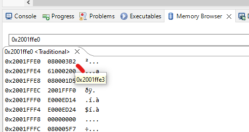

When I use the Memory Browser and display 32 bits wide, and hover my mouse over the LSB, it shows as at address 0x2001FFE3

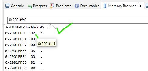

But, if I change the display to 8 bits wide, it clearly shows the LSB at 0x2001FFE1
Surely both should show 0x2001FFE1

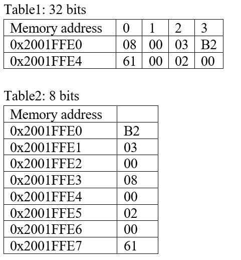

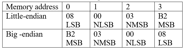

For my side it is not a bug it is the principle of little Endia format.
The difference between the Big-endian and the little endian is descripts in the below table.
The difference between the 32 bits and 8 bits wide representation in the little-endian format is find in the below tables:
