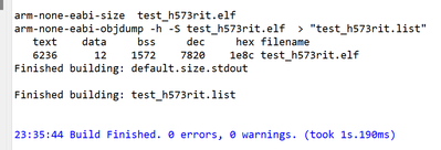

I am currently trying to develop for the STM32H573RIT6 microcontroller, however after generating a new project I run into an issue where I am unable to compile any code due to main.h attempting to include "stm32h5xx_hal.h", but it fails to compile as it fails to locate that file. The only file that I was able to locate was "stm32h5xx_hal_conf.h", but replacing that in the "main.h" file still fails to compile as it cannot find "stm32h5xx_hal_spi.h" and "stm32h5xx_hal_gpio.h". system_stm32h5xx.c also attempts to include the "stm325xx_hal.h" file as well and as a result errors.

It seemed like there were some firmware packages that were not finished being installed which caused the errors. Signing back into myST and then redownloading the packages and creating a new project ioc file fixed the issue like you said, Mahmoud. Thanks both @TDK and @Mahmoud Ben Romdhane for your guy's help.
