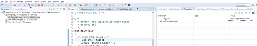

I am using the STM32 Cube IDE.
I want to monitor real-time variables through debugging mode.
But it doesn't...
How use to Real-Time variables??

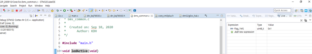

2020-09-13 7:21 PM
Do you mean this?

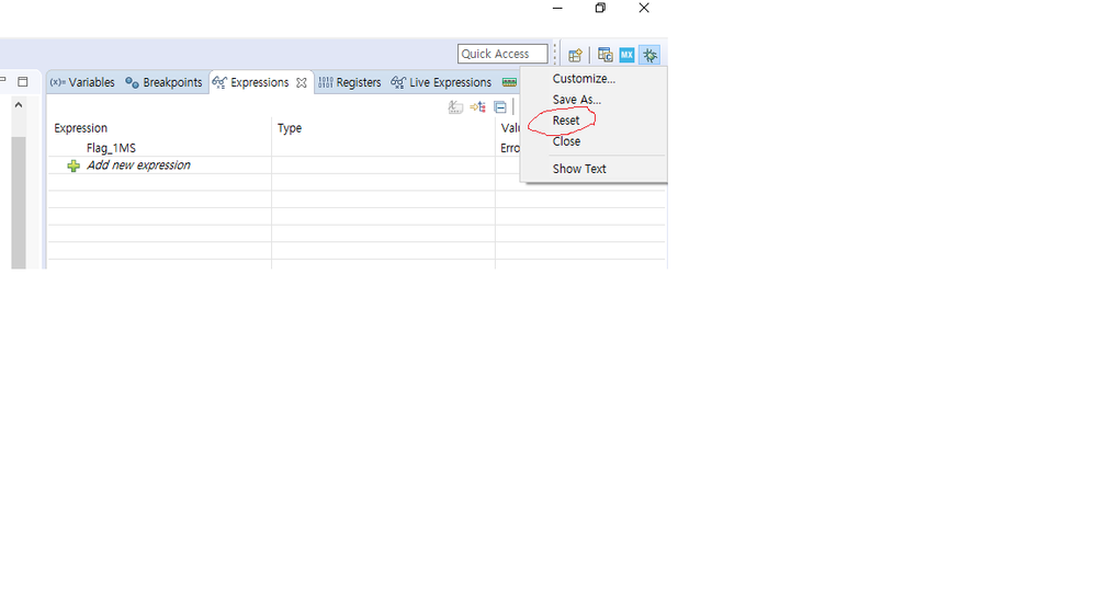

2020-09-13 7:28 PM
The "Live Expressions" tab is two tabs to the right of the "Expressions" tab on your last screenshot.

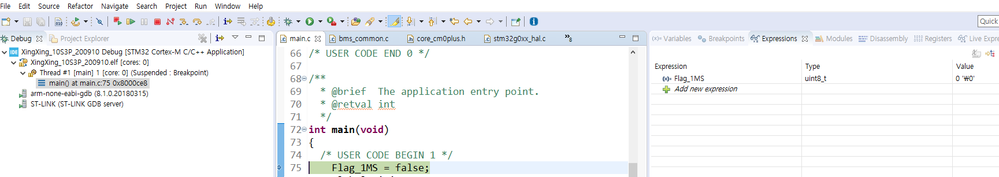

2020-09-13 7:35 PM
I think it's mean.
Is it right??
But It isn't real time variables...
It has a fixed value.
I toggled it every second by program.

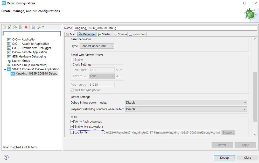

2020-09-13 9:04 PM
I used ST-LINK/V2.
Target mcu is STM32G030C8T.
VDD
GND
SWCLK
SWDIO
Debug Setting.
I programmed the variable to increase by 1 every second.
However, after changing from the initial value 0 to 1, nothing has changed.
