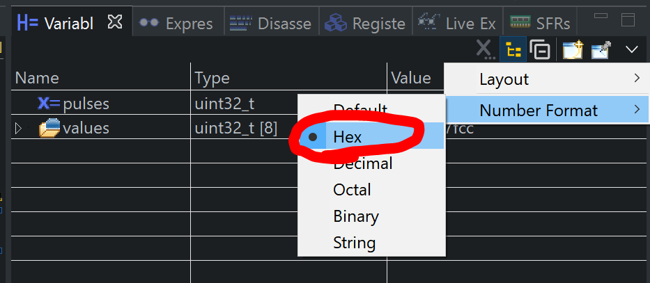

Don't click the tab. Click the down arrow on the top right of the variable tab to change the default number format.
Works for me. Win10 STM32CubeIDE.
Make a screenshot to show what you're doing instead. Sounds like you're not understanding.

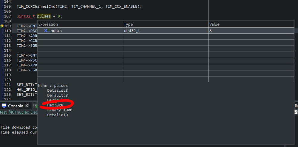

It displays the value in hex at the bottom of the expression window, along with binary and octal.

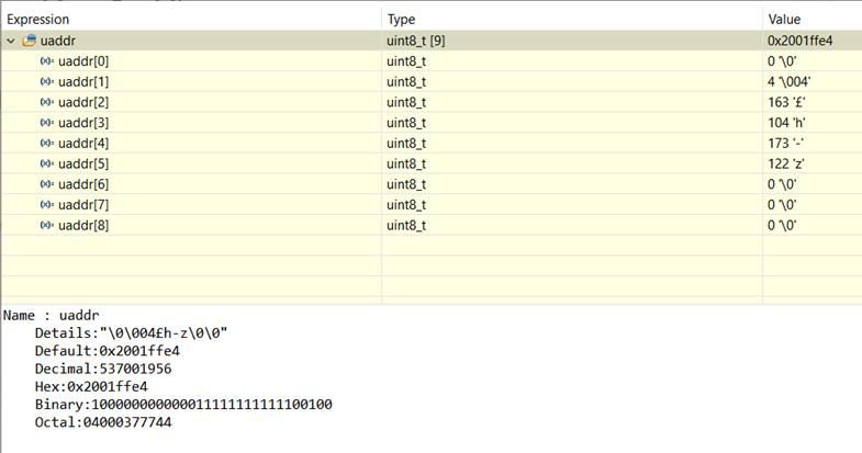

TDK, that works fine for a single variable. But it is useless for an array. I have several uint8_t arrays. The individual elements of the array in the Value column of the Expression window display as decimal values. The Hex display doesn't show the individual elements of the array. In fact, I don't know what that number refers to.

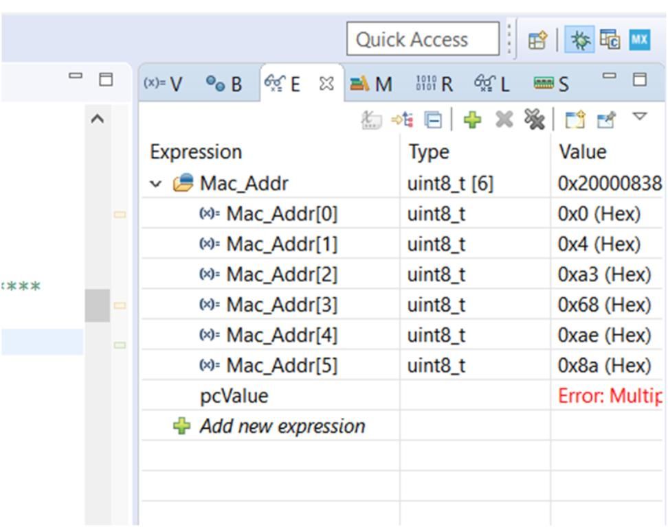

The hex values of the attached screen shot are 0x00, 0x04, 0xA3, 0x68, 0xAD, 0x7A. That is what I would like the Value column to display.
Sorry for the image size. I don't know how to make the image larger.

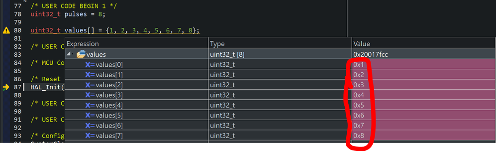

Pick hex format as the default number format for variables.
After that, values in hover will be displayed in hex by default.

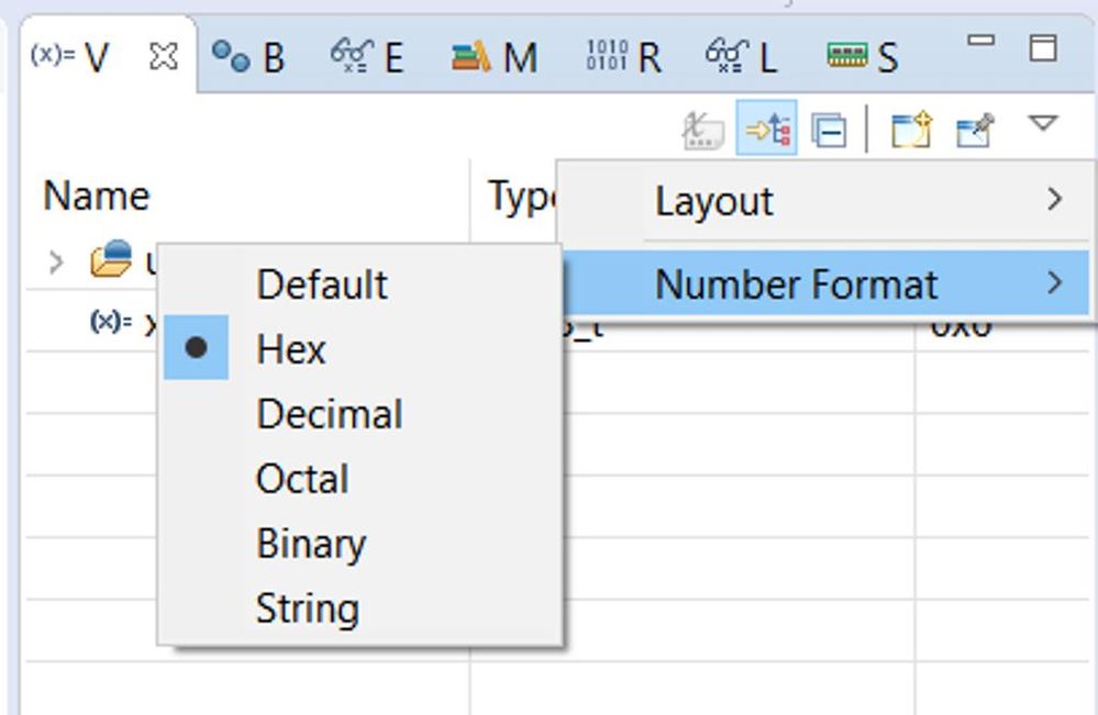

> Unfortunately that does not work on my system.
2020-07-12 6:54 PM
Attached is a screenshot. I don't see a down arrow on the variable tab. However, as I mentioned in my last post it does work if I set the variables to hex and restart STM32cubeide. So I guess it is working well enough for debugging purposes.
2020-07-12 7:09 PM
TDK, I see what you mean now. The down arrow is on the far right of the toolbar above the Value column. That works and changes the variables to hex.
