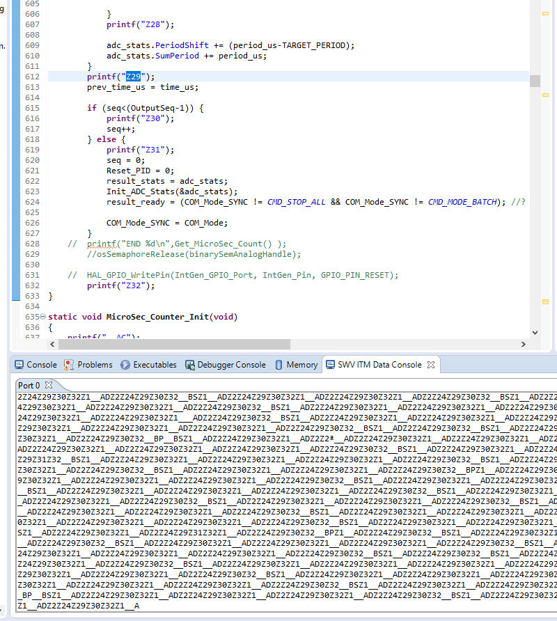

Hi , thank you very much for your reply. I have been using this method to debug my program. My program is quite big, i tried my best to put a short printf function such as printf("_A1") or print("_B20") in every functions inside main.c. I will then use SWV ITM Data Console and check the printf output of the program after running for a few seconds. An data console would look like the following

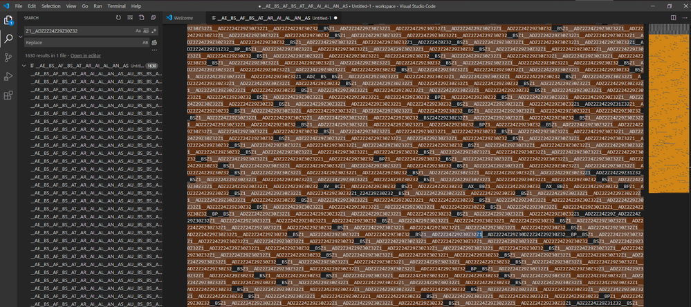

I then copy paste the console output, and put into Visual Studio to find irregular pattern and try to deduce the cause
For example, the correct sequence should be Z1__ADZ2Z24Z29Z30Z32, but the sequence became Z1_Z24Z29Z30Z32, a function with printf("_AD") is not fired at all.
Another example is Z1__ADZ2Z24Z29Z30DZ2Z24Z29Z30Z32, a function with printf("Z2") repeats itself twice, which shouldn't be possible , unless something have messed with the program counter, which is definitely not done by me intentionally. The other possible cause is the freeRtos is messing with the stack pointers to make sure that all task's are fired at the right time interval etc. (i'm stuck in this part for few weeks already, can't solve the bug )
