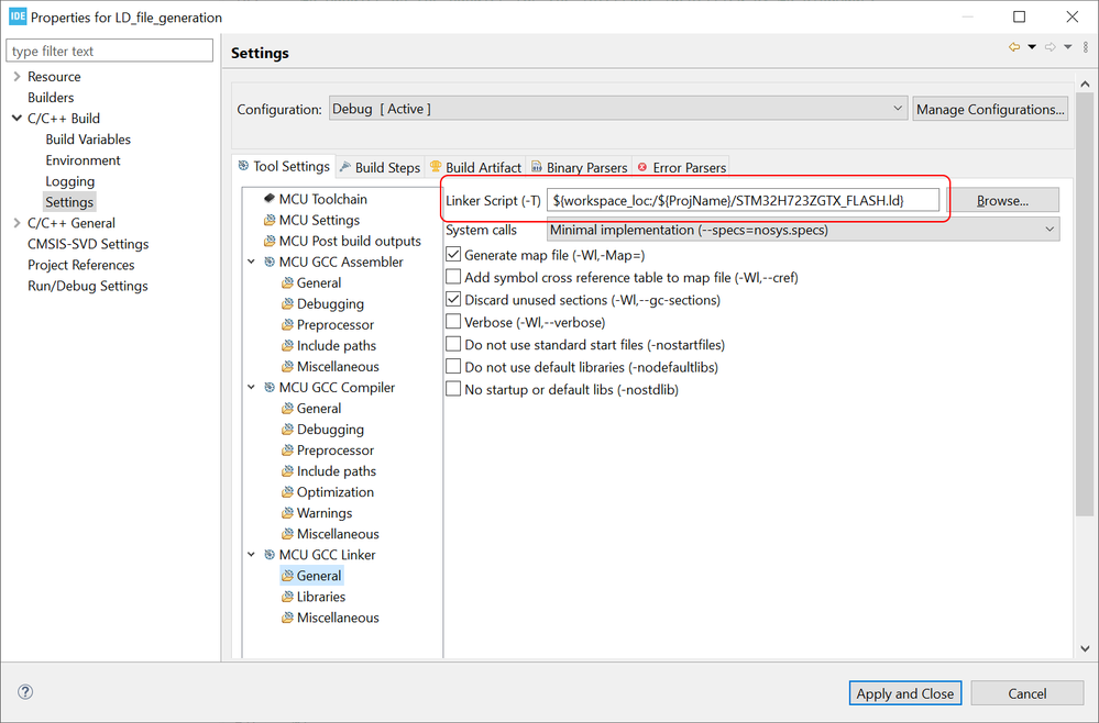

Hi Knarf,
I did look at the two .ld files and I saw they were different, so when I push the "build" button which one is the build using? My guess is it is using the xxflash.ld as the program loads and runs.
Best regards
Rob
Hi Rob,
right. You can check or change it in Project Properties0693W000008wTkzQAE.pnghth
KnarfB
