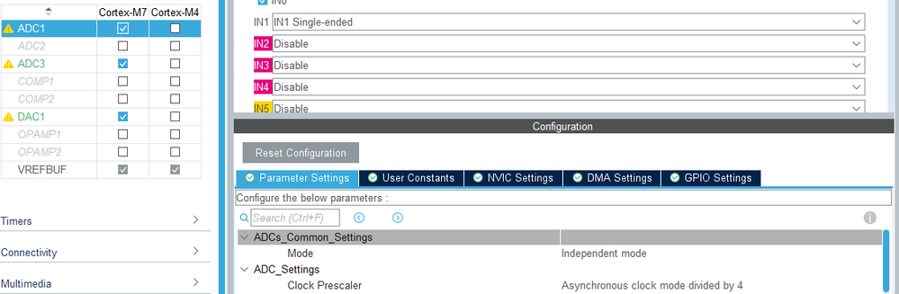

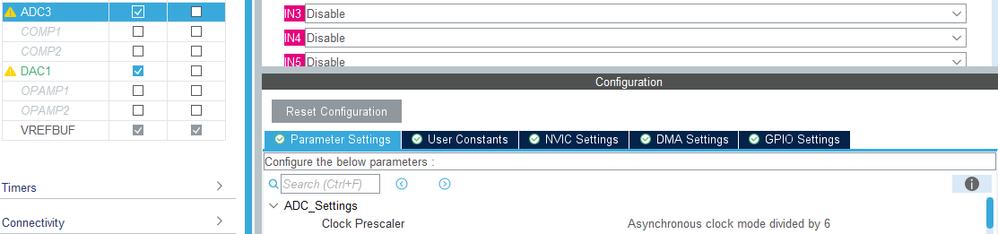

In the IDE GUI, when selecting asynchronous clock division for ADC3 on STM32H747XIH, the value generated in the code seems to be taken from ADC1, e.g.:
ADC1 (divided by 4):
ADC3 (divided by 6):

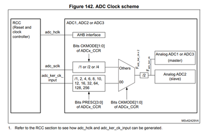

The ADCs have only one common clock/prescaler here :
So the setting can be only one for all ADC 1,2,3 .

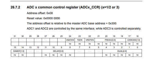

@AScha.3 It doesn't seem so clear to me, if you look at the register description, RM first states that CCR is common for ADC1 and ADC2 and ADC3 is controlled separately:

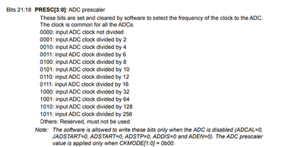

and then for the CCR.PRESC value, it states that all the clocks are really common:

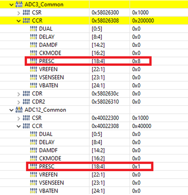

And ADC3 really has separate CCR register and different value can be written to the PRESC field:
But if it really is common, the GUI configuration tool should force the same value for ADC3 and ADC1 (this binding is already there for ADC1 and ADC2).
