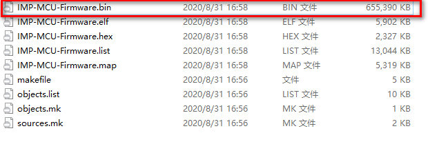

I'm using STM32CubeIDE, Settings ->Tool Settings->MCU Post build outputs-> Choose "Convert to binary file(-O binary)", I found that the generated bin file was not the right size. The elf and hex is correct.
.elf: 5902KB
.hex:2327KB
.bin: 655390KB
Obviously the bin file size is wrong.

Hi Lliba.1
One reason that the bin file is so big can be that the project contains code split to several memory areas. The bin file does not contain any address information so if the project is mapped to several memory areas it will become big as unused memory needs to be filled by zero in the bin file.
Please let me know if this is the case for your project.
You can disable the generation of the binary file in Project Properties. "C/C++ Build" -> Settings . In the Tool Settings tab you will find settings for "MCU Post build outputs"
