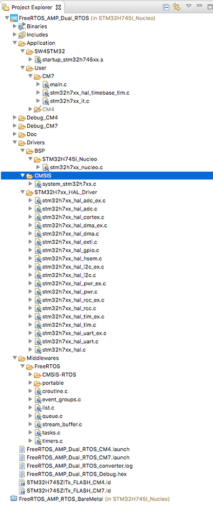

OK, now I want to enable the DAC. From grepping the sources in the project, it doesn't look like the HAL code that was built, presumably by CubeMX, has the DAC set up. (If you suspect I am wrong about this, tell me what I should grep for to disprove it).

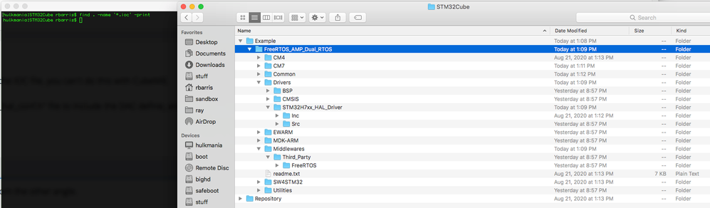

Observation - everything I read about CubeMX involves .ioc files. But there is no .ioc file in the example directory in the IDE workspace (I checked with 'find'). There are a few in the IDE package that match this board:
./Applications/STM32CubeIDE.app/Contents/Eclipse/plugins/com.st.stm32cube.common.mx_6.0.0.202007160824/db/plugins/boardmanager/boards/G71_Nucleo_NUCLEO-H745ZI-Q_STM32H745ZI_Board.ioc
./Applications/STM32CubeIDE.app/Contents/Eclipse/plugins/com.st.stm32cube.common.mx_6.0.0.202007160824/db/plugins/boardmanager/boards/G71_Nucleo_NUCLEO-H745ZI-Q_STM32H745ZI_Board_AllConfig.ioc
./Applications/STM32CubeIDE.app/Contents/Eclipse/plugins/com.st.stm32cube.common.mx_6.0.1.202008101643/db/plugins/boardmanager/boards/G71_Nucleo_NUCLEO-H745ZI-Q_STM32H745ZI_Board.ioc
./Applications/STM32CubeIDE.app/Contents/Eclipse/plugins/com.st.stm32cube.common.mx_6.0.1.202008101643/db/plugins/boardmanager/boards/G71_Nucleo_NUCLEO-H745ZI-Q_STM32H745ZI_Board_AllConfig.ioc

In a separate attempt, creating an example project from scratch, 0693W000002lwFGQAY.pngI thought I went through the steps with the CubeMX tool correctly, but that resulting project folder doesn't have an .ioc in it either.
