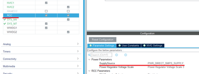

What Power supply you configured for that board in CubeMx? SMPS or LDO?
If LDO. That's normal. in that case you have locked the MCU, unless you modified the board hardware to support LDO mode.
This is the config you have to set in CubeMx:
If you have already configured the power supply to LDO (at least once), you need to recover your MCU from the lock state. Read: How can I recover my STM32H7/STM32H7RS board after facing a power configuration deadlock?

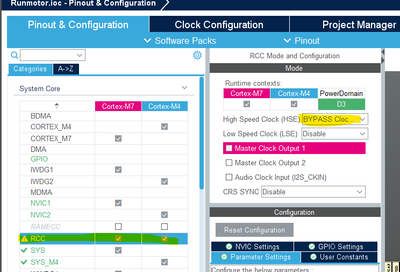

Tried with configuring HSE clock, and changing clock configuration which has provided in community
