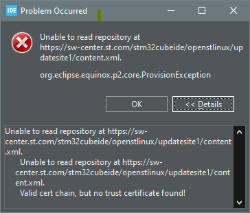

after installing STM32CubeIDE v1.11, I get the following error when running Help-->Check for updates
I've already tried the hints from other posts like clearing the cache, checking proxy, checking the https addresses, etc.
Other updates work, like Help-->Check for Target Selector Device Database Updates.
I've also uninstalled STM32CubeIDE completely and freshly installed v1.13 but the behavior remains.
Any help would be appreciated.
Regards,
Peter

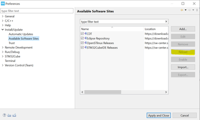

Hello @PowerStation ,
At first, could you try to check the proxy settings following these steps:
- Under Window --> Preferences--> Network Connections, activate Native provider
- Under Window --> Preferences--> Firmware Updater, click on Check Connection
don't forget Apply and Close, if the connection works.
Also, reload OpenSTLinux Releases under preferences-->available software sites, as shown in this screenshot
Thanks,
Rim.
2023-09-26 7:50 AM
Hello Rim,
Native provider was activates but I cannot find "Window --> Preferences--> Firmware Updater, Check Connection"
Reloading OpenSTLinux Releases results in the same error message:
Thank you.
Regards, Peter
