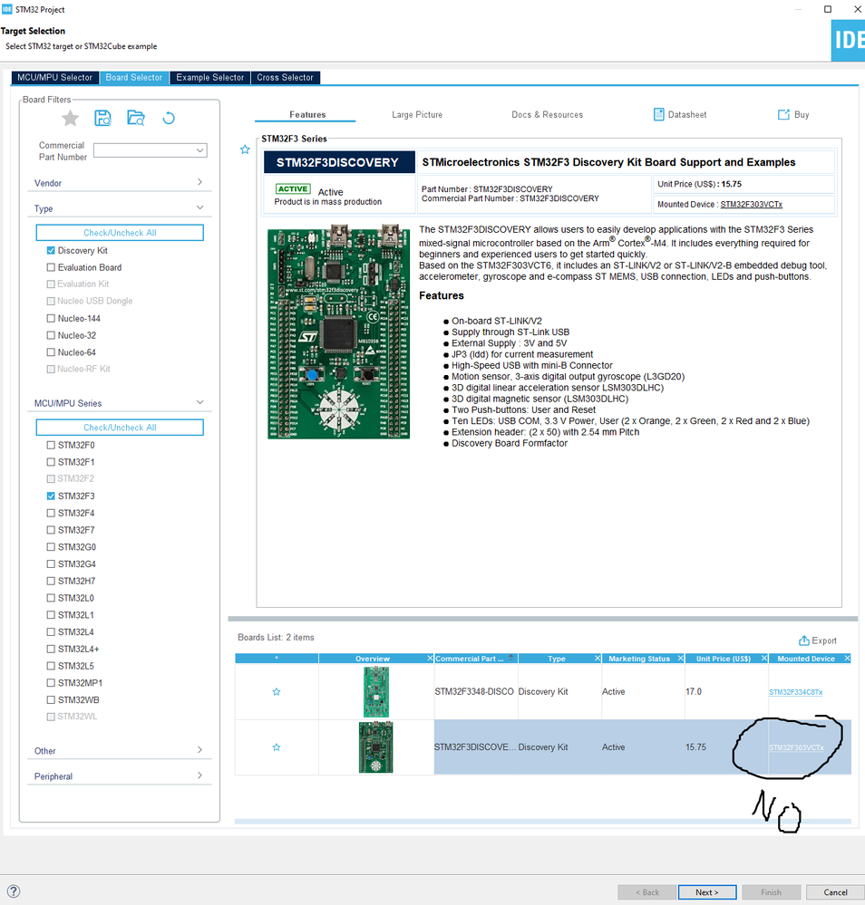

GOlin.2
Associate II
You are absolutelly right, at this point just click on "Next" instead of "STM32F303VCTx" in blue...0693W00000BbhnTQAR.png
Was so simple... thanks everybody!
