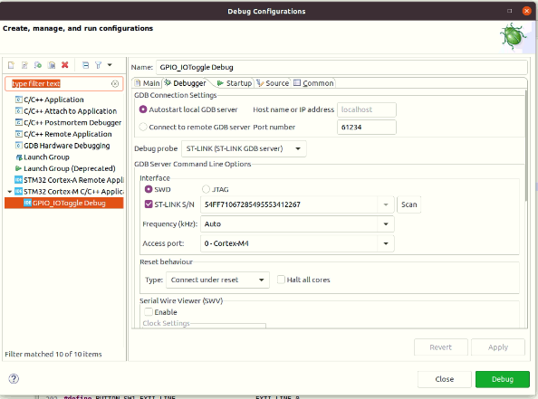

Hello all ..
I just started using STMCubeID with my Lora-E5 Development kit board and I picked a GPIO_IOToggle example from the SDK to run. I have already connected the STLink and I was also able to get it scanned in the debugger configuration (Run -> Debugger Configuration), as shown below:
The "Build (Ctrl+B)" is successful. But when I try to run it (Run -> Run), I am getting the below logs, indicating the error "stlinkserver already running, exit" .. Below are the logs:
