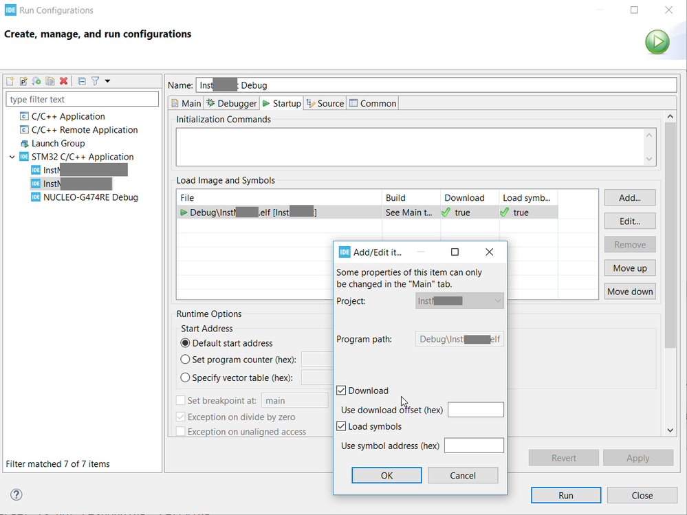

because I use the Flash-EEPROM-Emulation (eeprom_emul) I need to connect to the microcontroller with the debugger without programming it.
Where do I find the debugger-settings to connect to the target without flashing it, using the STM32CubeIDE and the StLink V3?
Thanks a lot, Best Regards, Seppel
2023-06-02 11:26 PM
Hi Seppel,
Debug Configurations > Startup > Load Image and Symbols
Edit the entry, set Download to false.
You can still load the symbols and debug, but must take care yourself that the correct binary is in the flash.
hth
KnarfB
2023-06-05 12:38 AM - edited 2023-11-20 4:10 AM
many thanks for the reply, it's a little hidden, I'll add a screenshot here for completeness,... and I can re-read it myself id I forget ;) .
Best regards, Seppel
