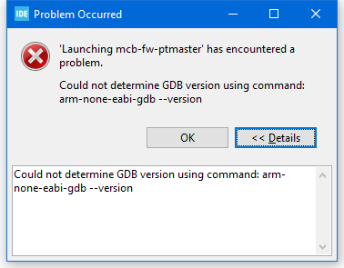

The error happens starting the second debugging session: the first session after starting STM32CUbe IDE is always successful.
This is the error window:
gdb error window

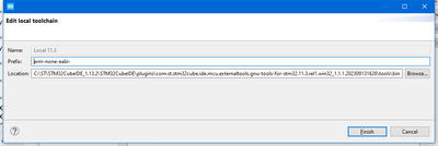

I tried forcing the path for the tools, the problem persists:
