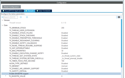

2025-01-22 6:06 AM
Hello @diverger ,
I have created a project with STM32F722ICK6 and I have installed and enabled X-CUBE-AZRTOS-F7.
tx_thread_interrupt_disable.S and _tx_thread_interrupt_restore.S are well generated.
Thanks.
Mahmoud
2025-01-24 6:26 PM - edited 2025-01-24 6:26 PM
It's weird that your MCU is a F7 based on cortex-m7, but it shows 'cortex-m33' in the picture. In my case, I use STM32F769.
Please check it.
Thanks.
2025-01-27 7:37 AM
Hello @diverger ,
Further to your comment, I am using STM32CubeMX 6.13 and ThreadX version: 6.1.10 not 6.1.7.
Thanks.
Mahmoud
