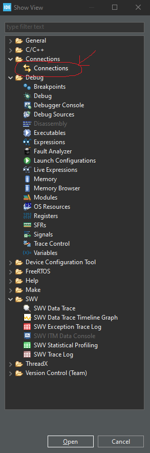

When selecting the connections view in STM32CubeIDE (latest version):

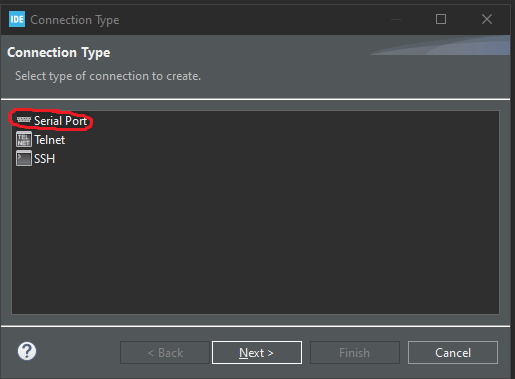

Then adding a serial port:

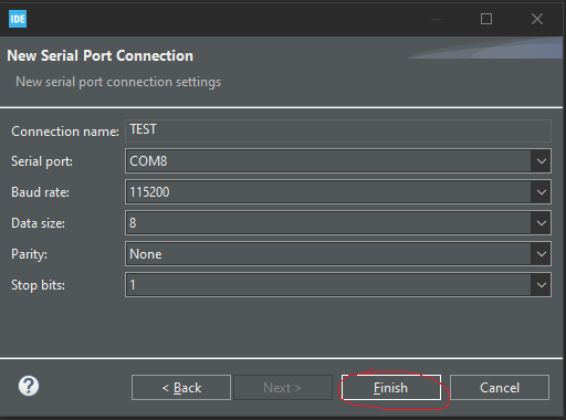

Then connecting to a UART connection on any of the Nucleo devices:
Then creating the connection:
The second you begin a device in run mode, the serial port connection is reset, as a part of the standard workflow of the Nucleo devices, then at that point, the STM32CubeIDE interface breaks (if you attempt to open the viewer shell using Connections->TEST->right click->Open Command Shell):
This means that you simply don't appear to be able to successfully use this feature to monitor a UART port on a Nucleo (or any MCU device) via a virtual COM port through the USB interface on a Nucleo.
