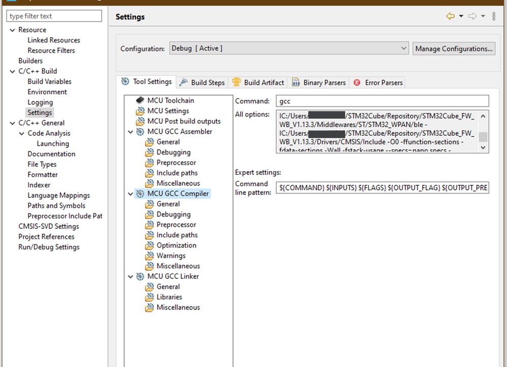

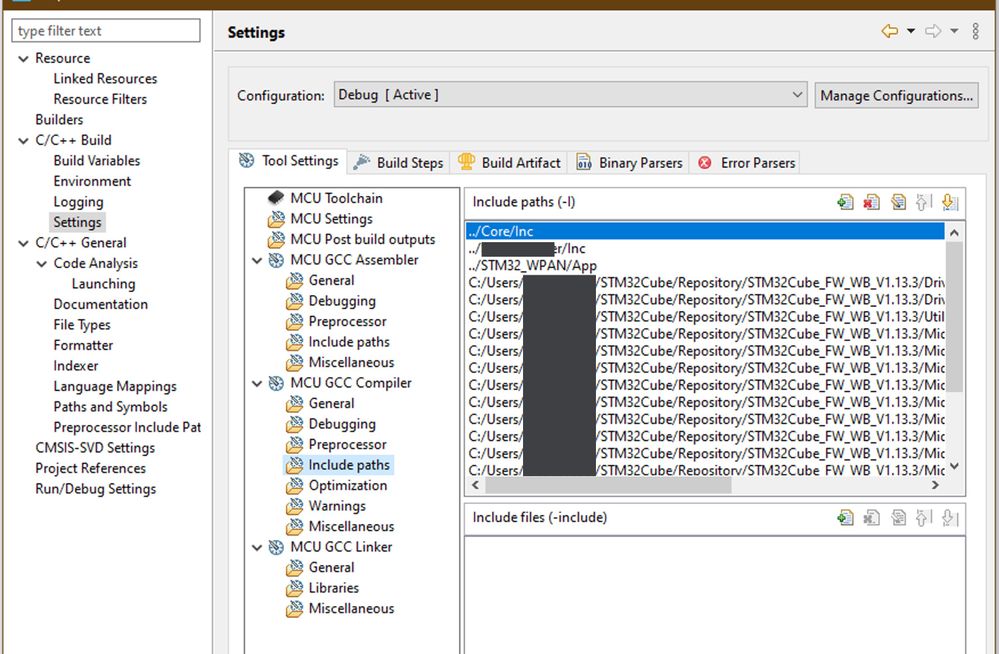

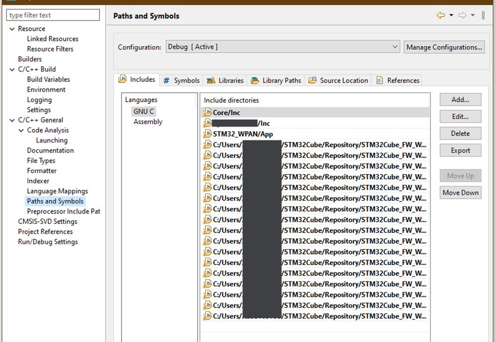

The projectxxxx_v3 was zipped and sent by Person12345. I am the Person67890 and have different version of STM32Cube_FW_WB_V1.14.1 : 'C:/Users/Person67890/STM32Cube/Repository/STM32Cube_FW_WB_V1.14.1/Utilities/lpm/tiny_lpm/stm32_lpm.c'
I tried to manually change the path settings in project property. But it seems there are still other places I don't know.
I can install the version in the copied project. But I cant definitely have the same absolute paths of the original.

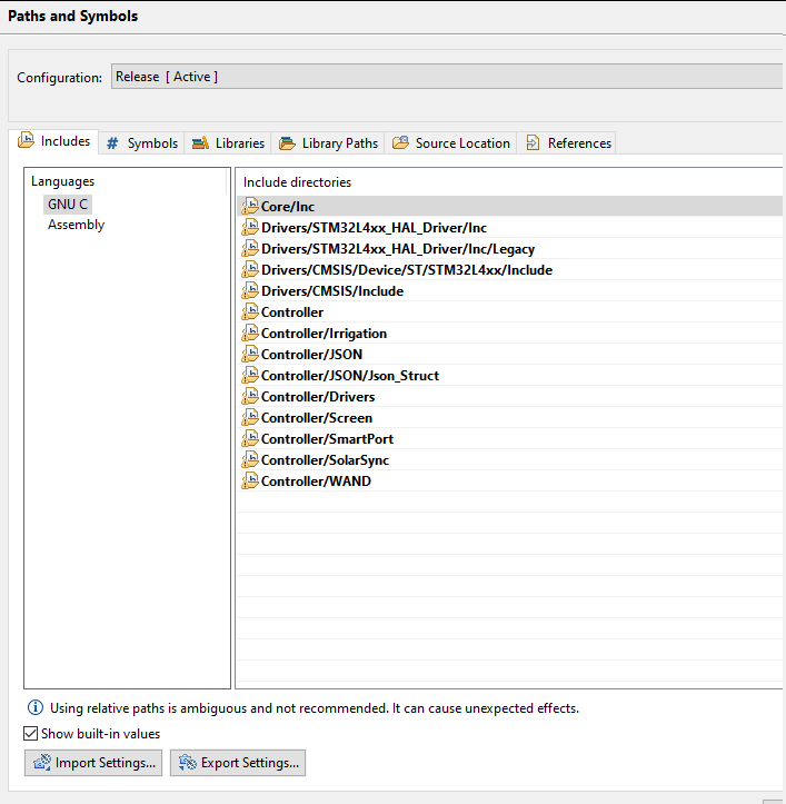

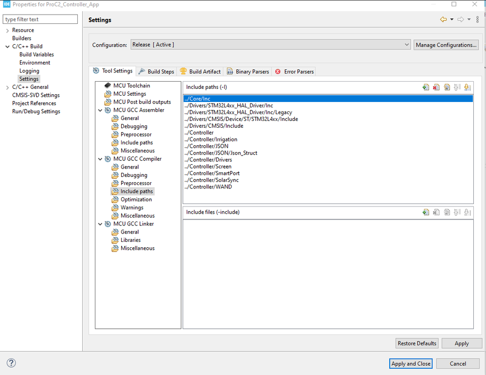

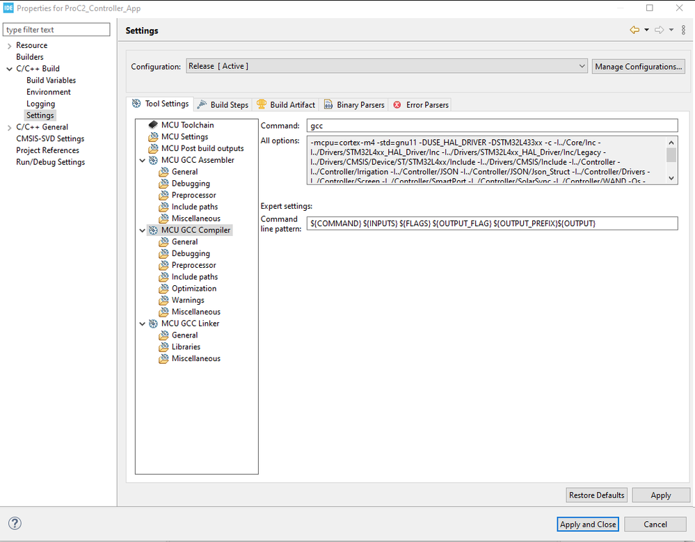

That weilrd, How was the project start ed originally. We do use Source control and we have 3 or 4 people using the same source files .. Here are the compiler settings in our code.
