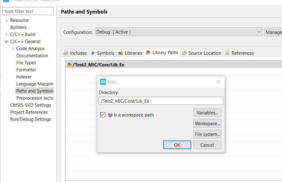

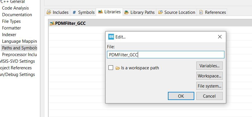

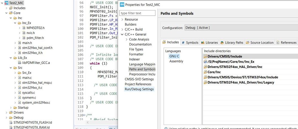

I have a problem when I add ARM DSP library, the following error appears:
c:\st\stm32cubeide_1.0.0\stm32cubeide\plugins\com.st.stm32cube.ide.mcu.externaltools.gnu-tools-for-stm32.7-2018-q2-update.win32_1.0.0.201904181610\tools\arm-none-eabi\bin\ld.exe: cannot find -lC:/IoT/../L59_stm32_examples/Libraries/CMSIS/DSP/lib/arm_cortexM4lf_math.libso I tried everything I know but not solved, I add the library to the project, change the name change extinction from.a to .lib, and here is some photo from my project.
Please help and thanks in advance!

Hi Rashad, I think you have to remove the "/$(ProjectName)/" in the Includes path and leave it as "Core/Inc/Inc_Ex".
My solution was for the DSP library. I've never used this other PDMFilter library. SonI don't know if I would be able to help you much more.
