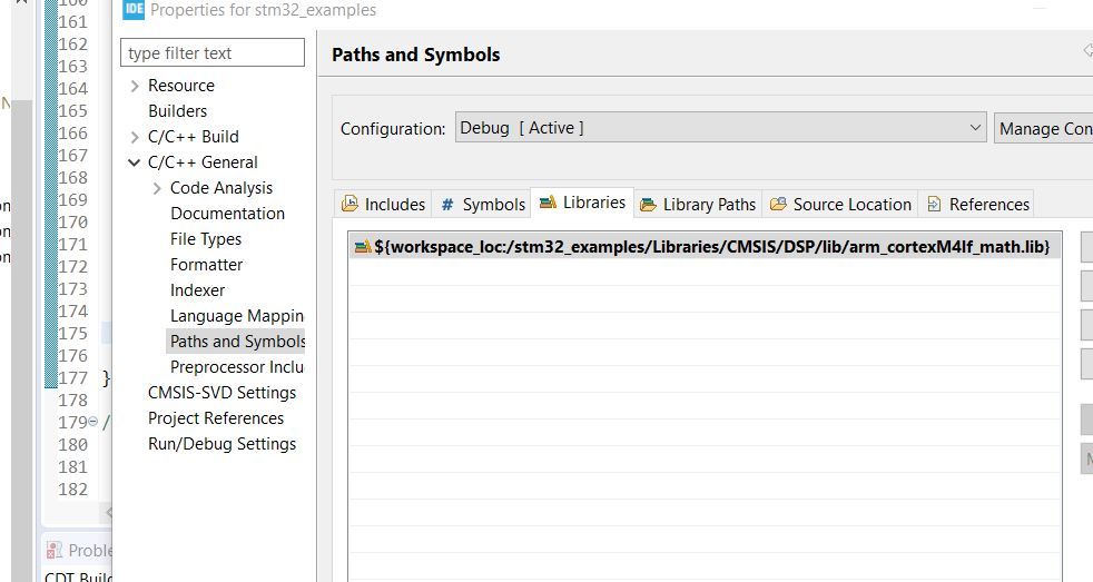

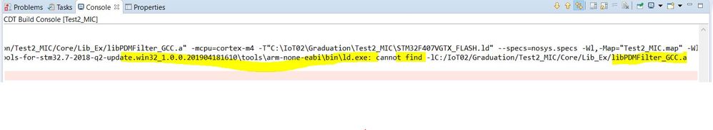

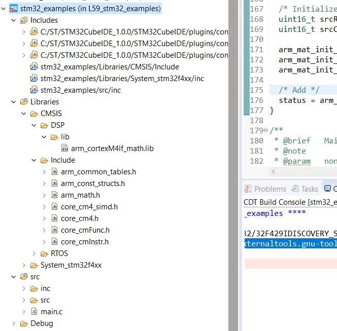

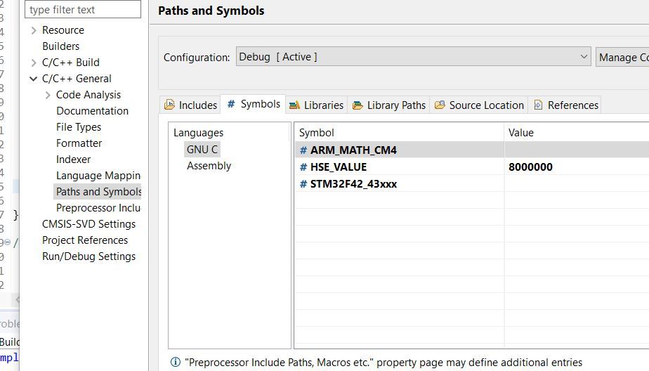

I have a problem when I add ARM DSP library, the following error appears:
c:\st\stm32cubeide_1.0.0\stm32cubeide\plugins\com.st.stm32cube.ide.mcu.externaltools.gnu-tools-for-stm32.7-2018-q2-update.win32_1.0.0.201904181610\tools\arm-none-eabi\bin\ld.exe: cannot find -lC:/IoT/../L59_stm32_examples/Libraries/CMSIS/DSP/lib/arm_cortexM4lf_math.libso I tried everything I know but not solved, I add the library to the project, change the name change extinction from.a to .lib, and here is some photo from my project.
Please help and thanks in advance!

Look for it in the repository directory if your chosen tool isn't pulling a localized copy into your project directory, or looking in the wrong place. My general view is the point of static libraries, and library source is that it doesn't need duplicating six ways to sunday, as it makes management of it more difficult, and increases the temptation to edit/modify them on a per project basis.
STM32Cube\Repository\STM32Cube_FW_F4_V1.25.0\Drivers\CMSIS\Lib\GCC\libarm_cortexM4lf_math.a
STM32Cube\Repository\STM32Cube_FW_H7_V1.7.0\Drivers\CMSIS\Lib\GCC\libarm_cortexM4lf_math.a
STM32Cube\Repository\STM32Cube_FW_H7_V1.7.0\Drivers\CMSIS\Lib\GCC\libarm_cortexM7lfdp_math.a
Suggest y'all get a File Manager or search tools allowing you to navigate files and directory trees to locate things you need to find

I've copied them into my project and linked manually in the project settings.
However, it doesn't feel natural that CubeIDE is copying all headers and adding the associated included automatically and the static libraries have to be added manually.

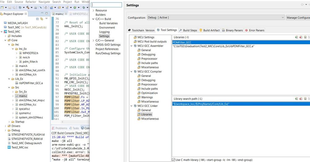

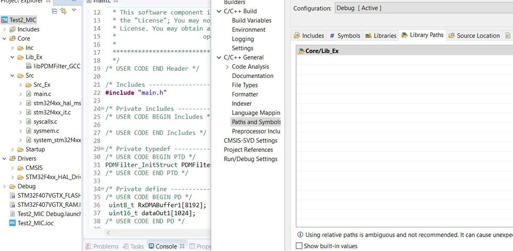

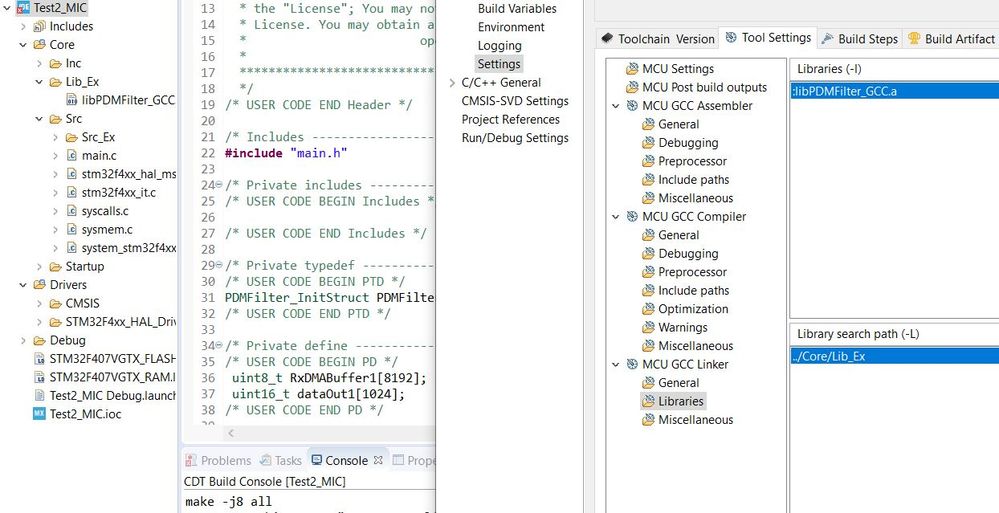

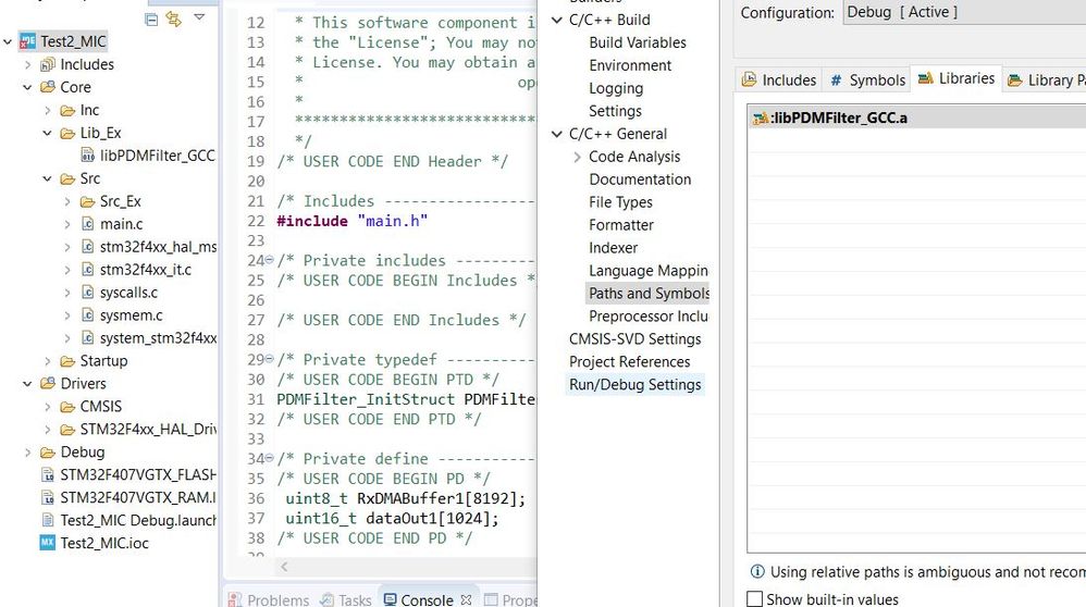

I also tried to use the PDMFilter(AN3998)library but the same error appears..Here some photos of the new project configuration.
So I try to test use the pdm2pcm library from cubemx and it seems to work very nicely with no error..also I take a look at how the library is implemented and then I make the same thing but this not solve the problem...
1#######
2###########

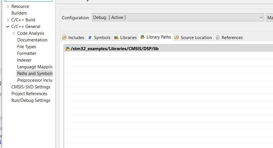

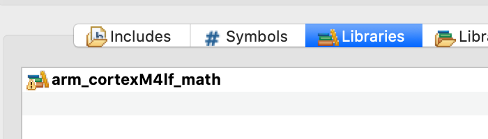

What I did is follow the steps described in my original post to get the include files available. Then, to solve the static library not found problem I just copied the libarm_cortexM4lf_math.a file to my project (without changing the name).
Then I added it to the "Libraries" list. Notice that without the .a extension and without the lib prefix.

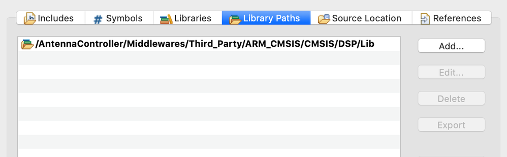

Finally I added the path to the library in the "Library Paths".
After this process everything worked.
