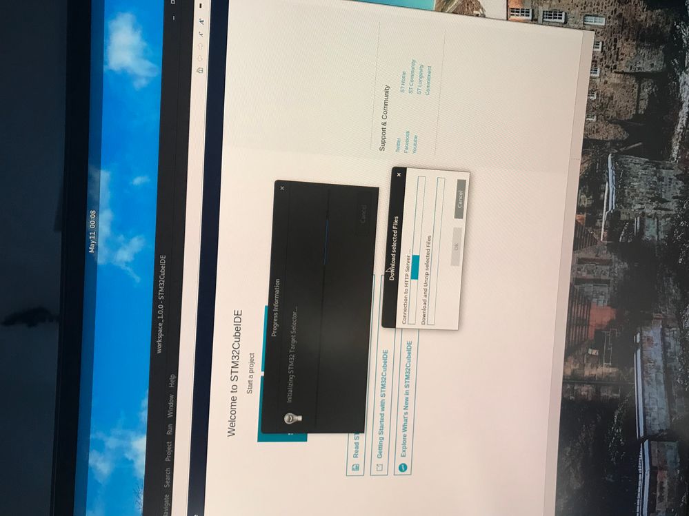

Under windows, there was a lengthy (relatively) download of some files before the 'select stm32 target' appeared and I could easily set up a blank project for my 746GDiscovery, which worked straight away right down to debug stepping.
This download appears to be attempted occasionally under ubuntu19.04, but often is so brief i couldnt take a screenshot. See:
Note, the eclipse internal internet browser does have access to the internet.

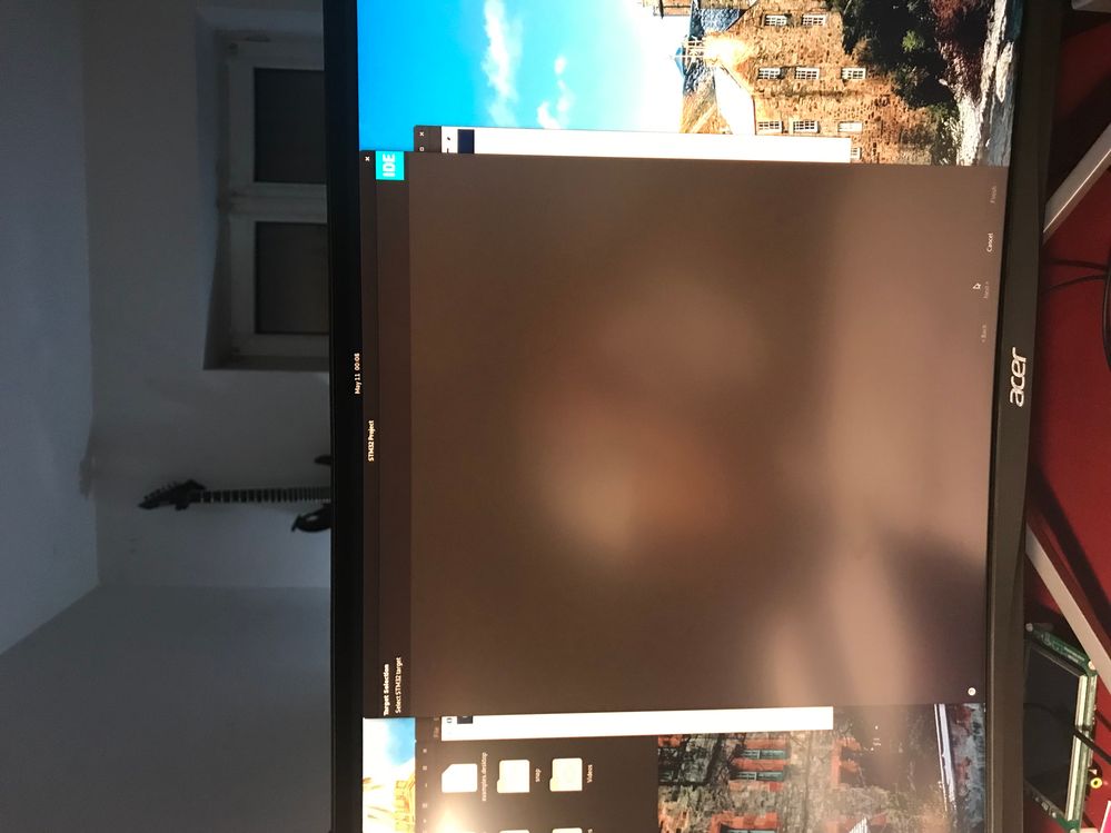

This is what is displayed, where there should be a bunch of project config stuff. Sorry for the rotated photos, they were right way up on my PC.
I will reboot into ubuntu and grab the log file you asked for.
