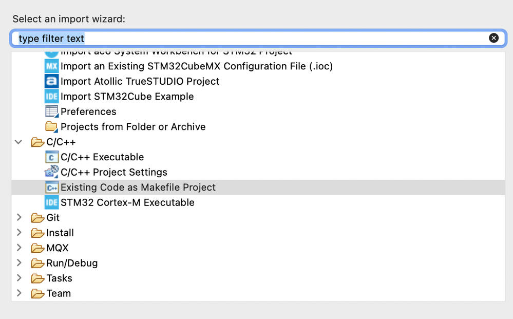

I recently upgraded to macOs14.2 while running IDE@1.13.2. This worked for a while... 2-3h. All the sudden the IDE kept crashing on me. So I upgraded to 1.14.0 which did not solve the problem. I can't even press on the small > icons to drop down additional information like files/settings.

Every time I try to open a drop down menu it crashes (like Git, Install, ...). If it's opened already it's fine.

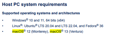

Hello @JE and welcome to the community,
According to the release note of STM32CubeIDE 1.14.0, macOs14.2 in not a supported operating system.
You can use only macOs 12 and macOs 13, as shown in the following screenshot.
BR,
Rim
2023-11-30 12:11 PM
Hi Rim,
thanks for your reply. I can confirm that the operating system was the issue. macOS 14.2 beta4 (current public beta) is the cooperate. I used time machine to downgrade to 14.1.1 which works.
