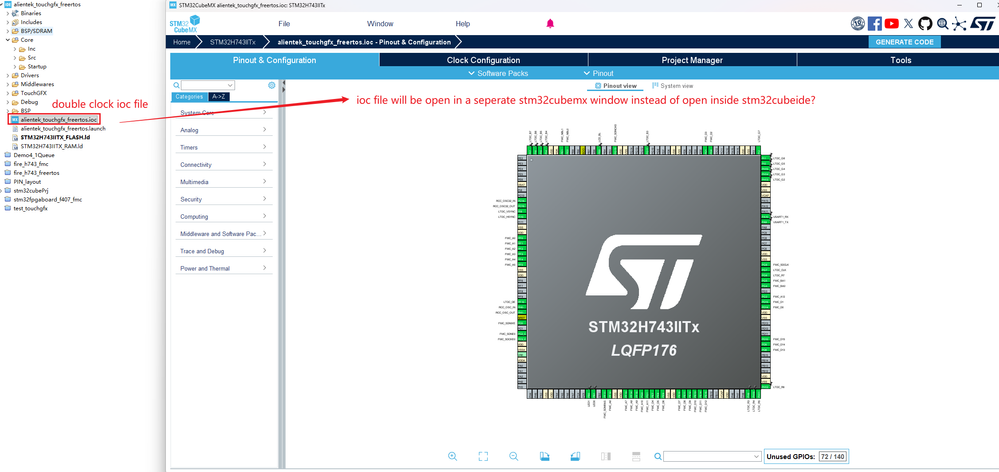

I do not know what happened. If I double-click ioc file, it used to open inside CubeIDE. But now it will open inside another separated cubemx window. I may have changed some settings by mistake.
How to change the settings back so I can open ioc file inside CubeIDE?

On the STM32CubIDE V2.0.0, the STM32CubeMX plug-in has been removed. So, the .ioc file is opened out of the STM32CubeIDE on the standalone version of the STM32CubeMX.

Did you update to CubeIDE 2.0?

Understood. I have already updated to STM32CubIDE V2.0.0. and this is the reason. Thanks.
