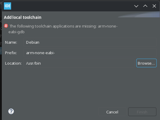

But the fact that your included toolchain requires ncurses5 is a real pain now.
Unfortunately STM32CubeIDE try to be too smart and when I try to add a local toolchain it complain there is no arm-none-eabi-gdb since debian moved to a multiarch gdb. This could probably be resolved by a symlink but it's not very nice to tweak with system stuff as root and I don't know if it is going to be maintainable.
You'd make adding a local toolchain more smart or less smart.

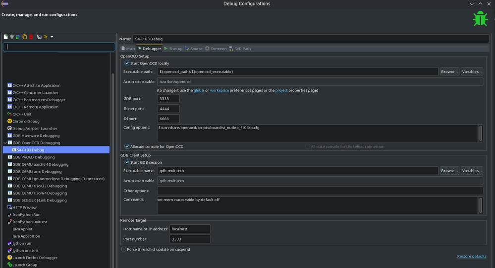

Embedded CDT uses OpenOCD and the debugger configuration is set in the GDB OpenOCD Debug option menu.
The equivalent setting would be in STM32 C/C++ Application -> project Debug. But there is no option where to chose the gdb binary.
