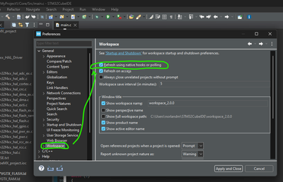

2025-12-14 11:49 PM - edited 2025-12-14 11:56 PM
Hint: CubeIDE can auto-refresh the Project Explorer by enabling this native Eclipse feature:
Window > Preferences > General > Workspace > Refresh using native hooks or polling
Use with care: If your workspace contains many projects/files, you may notice a performance hit.
