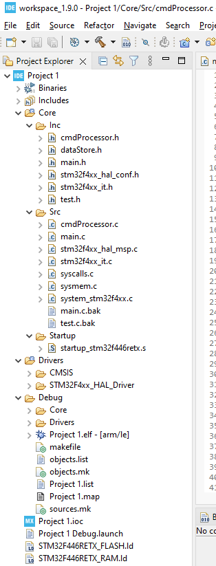

Hello there,
Could you take a screenshot of the structure of the project in your "Project Explorer" view in STM32CubeIDE? Might give us an idea of how the project is set up.
2022-05-02 4:02 PM
Hi Markus,
Thanks for your response. Hopefully, the project Explorer picture is legible. It is the cmdProcessor.c file that I'm having trouble with.
