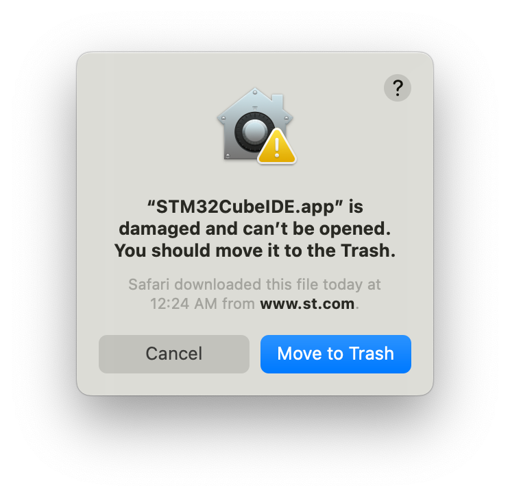

I'm running the latest (less than one week old) macOS Monterey developer beta 12.4 (build 21F5063e) on a MacBook Pro 10,1 and downloaded the file en.st-stm32cubeide_1.9.0_12015_20220302_0855_x86_64.dmg_v1.9.0.zip, decompressed and installed the app. But attempting to start the app causes a hiccup in the macOS first-time verification of the app and produces the following error:
Notes:
Has anyone else seen this? Recommendations?

I haven't tested this on Monterey myself but in the STM32CubeIDE installation guide we mention the following command that you can try with the Terminal:
xattr -c /Applications/STM32CubeIDE.appCould you give it a try and tell me the result?

Markus,
Bingo! That did the trick. Thanks for the suggestion. New one to me. I usually get around the gatekeeper with a right-click open.
