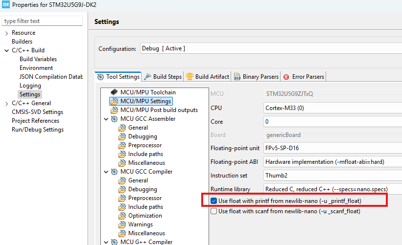

2025-04-10 12:31 AM
Do you have this setting?
2025-04-10 7:35 PM
Yes, of course, these settings were made first.
