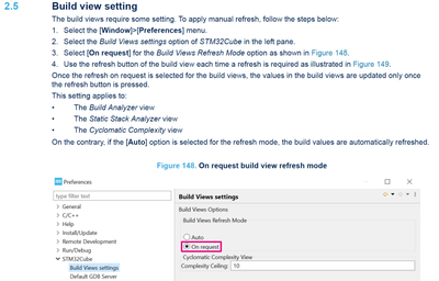

Memory regions were visible in STM32CubeIDE version 1.14.1. Later, I updated to STM32CubeIDE 1.16.1, and now the memory regions are no longer visible.
Could you please assist me with this?

Hello @MvA54 ,
First let me thank you for posting and welcome to the ST Community.
I suggest that you click on the "Refresh" button.
Please, refer to the User Manual, section 2.5 where this new button is explained and how you can change the behavior.
Thanks.
Mahmoud
