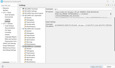

I would like some guidance on how to setup the STM32CubeIDE to allow me to use C++23 on the ARM toolchain I usually use.
The ARM toolchain is setup correctly but in the project's properties>C/C++ Build>MCU/MPU G++ Compiler>General, the language standard cannot go as high as iso or gnu C++20. Is there any way to write a value myself or do I have to use an external CMake.
Thanks for your help,
2024-11-04 6:45 AM
I just found a way to override the options of cubeIDE, you have to go to Project>Properties>C/C++ Build>MCu/MPU G++ Compiler and on Experts settings, add to the comman line pattern -std=gnu++23 after the ${FLAGS}. Because the gnu++23 is after whatever cubeIDE selected, your c++ standard option will be selected by G++.
I hope this will help anyone.
