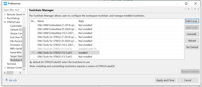

In fact, I am able to install GNU Tools for STM32(12.3.rel1) and STM32(13.3.rel1) on STM32CubeIDE 1.13.2 through the Toolchain Manger.
In this case the build is failed due to Program "nullg++" not found in PATH.
As Workaround, after installing GCC12 under this path:
C:\ST\STM32CubeIDE_1.13.2\STM32CubeIDE\plugins\com.st.stm32cube.ide.mcu.externaltools.gnu-tools-for-stm32.12.3.rel1.win32_1.1.0.202410251130.
Click on Add Local.
Prefix: arm-none-eabi-
Location:
C:\ST\STM32CubeIDE_1.13.2\STM32CubeIDE\plugins\com.st.stm32cube.ide.mcu.externaltools.gnu-tools-for-stm32.12.3.rel1.win32_1.1.0.202410251130\tools\bin
Then click on finish.
Best Regards.
Mahmoud

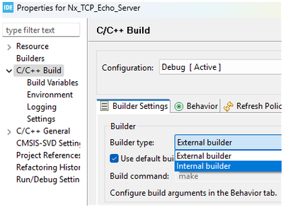

Try to switch to the "internal builder" , while waiting for more useful replies.
2025-01-06 1:00 AM
Unfortunately, External or Internal builders selection does not change anything. In both cases, the nullgcc error is present, and compilation is not possible with GCC ARM for STM32 v12.3rel1 here.

Hello @lmartinod ,
Further to your comment, I confirm the issue by my side.
Click on Add Local.
Location:
Best Regards.
Mahmoud

I fought with this for ages today, after a STM32CubeIDE update (1.18.0 to 1.18.1). The actual damage might have been the previous update, from 1.16.
The problem ended up being in the PATH variable, in Properties/C/C++ Build/Environment. The actual path to the build tools was in there, but it was pointing to an older non-existent folder. It was also set to USER: CONFIG, not Build System. If I changed it to either BULD SYSTEM (delete PATH) or fixed the path, it was all working.
I had edited the path to try an add 'touch.exe' to the tool chain, which is annoyingly missing.
