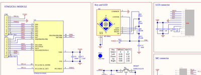

You have a board with cpu + connected hardware , and use the ioc definition, that matches this;
so no good idea, to disable ADC on a pin, where it get the voltage from a resistor divider, to check the buttons - right ?

see circuit of the board: https://www.st.com/resource/en/schematic_pack/mb1684-c011f6-b01-schematic.pdf
So the warnings are just useful for you, to not imagine something, that cannot be realized with the pins available on this cpu.
If you want more/other functions same time - take a cpu with more pins... here 20pins, 18 can be used, as you like.
