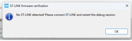

While using STM32CubeIDE I'm having a problem connecting to the device using the ST-LINK GDB server. I receive the following error message:

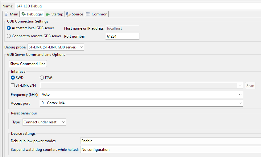

Here are the debugger settings:

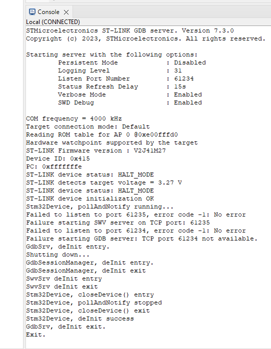

Setup a local console, manually executed ST-LINK_gdbserver and STM32_Programmer_CLI and received the following:

Hello @vicsimdelay
No ST_LINK detected please connect ST_LINK and restart the debug session
This message appears when you have a connection problem so try to change the cable or the port cable and tell me what's up

2023-04-10 2:22 PM
The issue was traced back to the internet kill switch.
