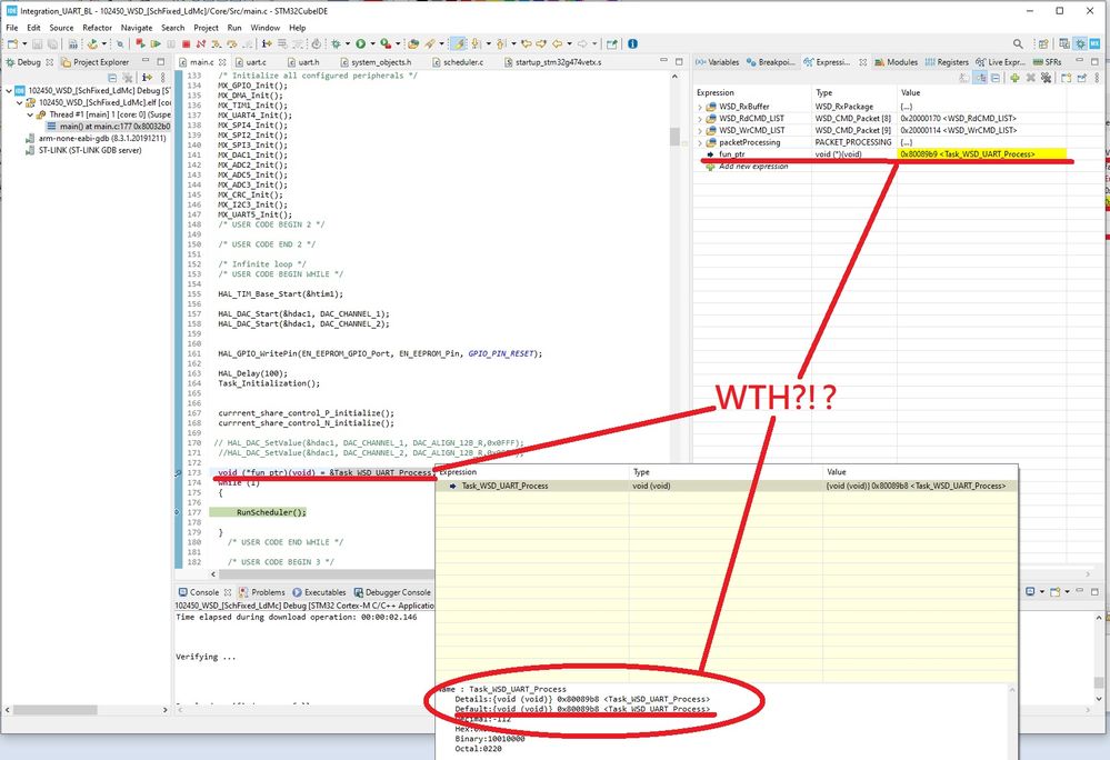

After updating to v1.7.0, all my function pointer or even pointer assignments got mess-up. Function pointer value will be automatically +1 by mistake.

Hi, Knarf, thanks for the info.
But in my case, this automatically "add one" does cause except failure to jump to the function that pointed.
I have to manually -1 or +2 the address to get it works. Ex. in picture:
Task_WSD_UART_Process() @ 0x80089b8.
fun_ptr = &(Task_WSD_UART_Process - 1); // call successfully, fun_ptr = 0x80089b7
fun_ptr = &(Task_WSD_UART_Process); // call failed, fun_ptr = 0x80089b9
fun_ptr = &(Task_WSD_UART_Process + 1); // call failled, fun_ptr = 0x80089b9
fun_ptr = &(Task_WSD_UART_Process + 2); // call successfully, fun_ptr = 0x80089bb
I'm using thumb2 instruction set.
-mcpu=cortex-m4 -c -x assembler-with-cpp --specs=nano.specs -mfpu=fpv4-sp-d16 -mfloat-abi=hard -mthumb
How can I avoid this if it's related with thumb state?
