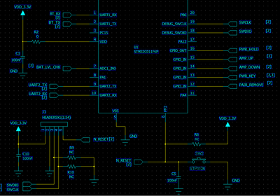

This is the schematic.
Peter BENSCH
Can you please upload a photo of the ST-LINK/V2?
