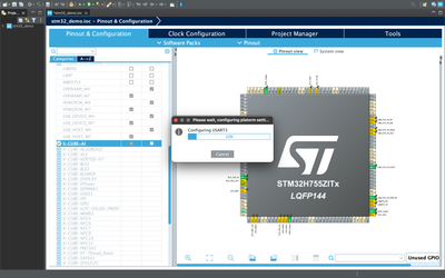

1. when i try to open the XcubeAI interface a dialogue pops up saying setting up USART3 but it never stops loading, i suppose its a bug but i leave it to the experts to decide what it is.

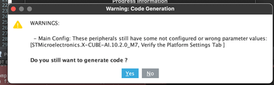

3. When am trying to build the model i got this error:
error: unknown type name 'ai_i8'
error: unknown type name 'ai_handle'
fatal error: bsp_ai.h: No such file or directory
Please help me out and guide me how to run this basic project on my board i found on the internet: https://github.com/stevemac321/5_Class_Embedded_Keras/tree/main
i have attached the bug's screenshot and error screenshots for reference

Hello @vigneshn10
Regarding the first point, the pop up of "Configuring USART3" is expected as the USART3 is used in Human Machine Interface(VCOM),
To avoid this, you should disable the HMI under Bsp or enable another USART peripheral.
For the other point, they are not related to CubeMX scope. This should be checked with the X-Cube-AI team.

Hello @vigneshn10
