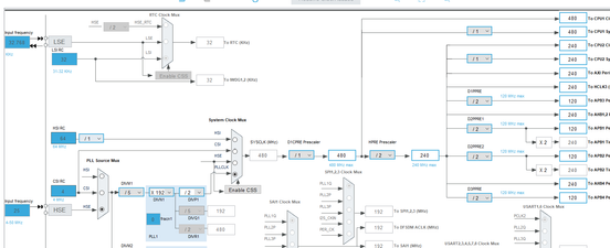

My settings for the clock:
RCC settings:

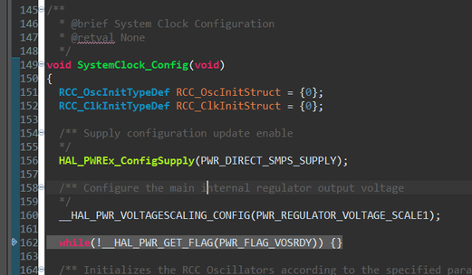

Then I wanted to debug again and the M4 core passed out and the M7 core ended up in this while loop in system clock config:
I tried multipel things: 1. lower clock config 2. lower clock config in combination with SMPS instead of LDO, but nothing works. Can anyone help me please? Thanks!!

I need to ask what is the STM32CubeMX version used? The GUI seems to be the old one.
Also, the "SupplySource" generated code is not aligned with the STM32CubeMX configuration: In the STM32CubeMX the configuration is "PWR_SMPS_1V8_SUPPLIES_LDO" and in the generated code is "PWR_DIRECT_SMPS_SUPPLY"
