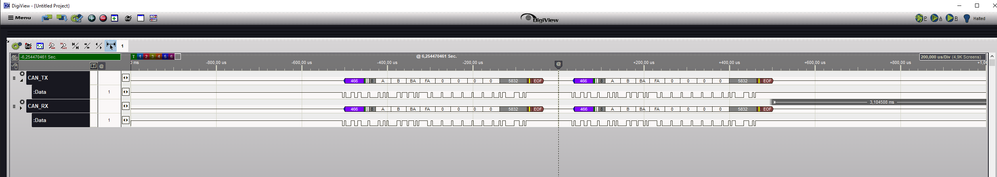

I am using CAN BUS in Loopback mode and data passing is correct. This can be seen in screenshot from Data analyzer attached below.
Leads from Logic analyzer are attached DIRECTLY onto pins that are goin into nucleo's socket.
From output you can see what is the problem I am facing.

No it is fine :grinning_face_with_sweat: . I tried to make CAN BUS work for at least 2 weeks now, so you can see my frustration LOL. Sure your idea is fine... a lot of times i use built in LEDs. They are great "I am ALIVE!" indicator. But sometimes you just can't get to the board and face check the LEDs.
Now I was running in Loopback mode since I wanted to eliminate all other factors.
I am using logic analyzier which can be used to check CAN packets.
But of coruse you knew that since I wrote this things a few comments above ;) .
