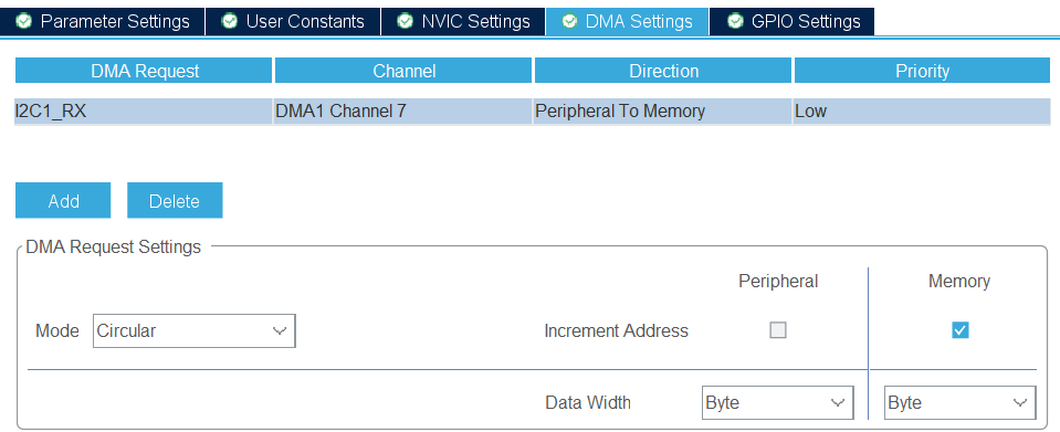

I am trying to read data from a sensor in the background(using DMA) using I2C. Below the I2C DMA settings on CubeMX. The problem is that it shows a frozen measurement on the debug window although in the blocking mode the measurement floats all the time. Which setting I could have missed?

2022-12-07 4:09 PM
> HAL_I2C_Mem_Read_DMA (&hi2c1, QMC7983_ADDR,STATUS_REG_1,1, &status_flag, 1);
> if((status_flag & 1U>>0)!=1)
Use blocking mode (non-DMA) or wait for the call to complete before using the data that it populates.
What does this mean exactly? measurement floats? shows a frozen measurement?
2022-12-08 2:32 AM
by frozen I mean the measurement is stuck, as if it reads only one measurement(fixed) no matter if a heat the sensor a little bit.
Float means that the measurement changes constantly in the debugging window(but around a specific reference value)
2022-12-08 2:34 AM
What do you mean by this?
