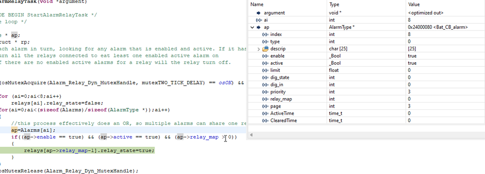

I am trying to understand what I am doing wrong here. The following image was captured during a debug session to show strange behaviour.
In the If statement ap->enable and ap->active are both true, but ap->relay_map is 0, as shown on the right, so this should evaluate to false. So why does the processor execute the statement within the brackets (shown by the green highlight) since the If fails? It actually crashes the processor because the index evaluates to -1 which is out of bounds of the relays array.

I have managed to prove that although the debugger actually looks like it steps to that line under these particular circumstances, in fact it does not execute the statement it steps to.
I put a line in between to turn on the LED. It steps to that line 10 below, but doesn't execute it, the LED does not turn on.
So apologies for wasting everyone's time. This is just an artefact of the debugger operation and not real.

@CYBR wrote:I cannot prove that it is actually executing that code line, because I don't know how to look at that memory location to see if it is being written to. But the debugger certainly steps there. It may all be just a case of the debugger stepping to a line it doesn't actually execute. I have seen it do that a lot.
You can try opening disassembly window and step through machine code. You can also inspect memory in memory viewer window.
