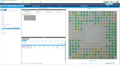

Hello @nilssonm
As shown in the following screenshot
CubeMX is warning about a debug conflict:
Debug Conflict with:
PE0 mapped with GPIO_Output and
PA15(TDI) mapped with ULTCD_RS and/or
PA05 mapped with GPIO_input and/or
PD0 mapped with GPIO_input and/or
PD1 mapped with GPIO_input
This prevents the debugger from working because the hardware cannot use the same pin for both debugging and another peripheral at the same time.
This is the root cause of your "Target not halted" and ST-LINK errors.
CubeMX is intentionally designed to offer flexibility, allowing you to customize or reassign pin functions according to your project’s requirements. While it provides warnings about such conflicts, it leaves the final decision to you.
THX
Ghofrane
