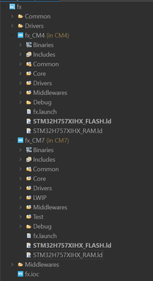

I have a STM32 project created for STM32H757 which has dual core CPU. The directory structure is look like this:
I wanted to build this project using command line in my ubutnu machine. I have tried with this command:

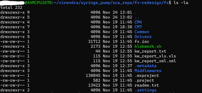

I have tried running it from root of the project directory like "<REPO_PATH>/sca_repo/fx_redesign/fx", also tried it running from inside the fx directory too like "<REPO_PATH>/sca_repo/fx_redesign/fx/CM7/". But output does not changed, I can not figure out what I am missing here, can anyone help me ?

</projectDescription>I am running this command from the root directory. My actual path for the project is:
/home/virendra/sca_repo/fx-redesign/fxHere are the contents of this path:

fx doesn't appear to be a CDT project. means that CubeIDE does not recognize it as an Eclipse/CDT project,
Could you please check if any of your project files are missing (i can't see .cproject in your path) or try to re-import your project in stm32CubeIDE;
